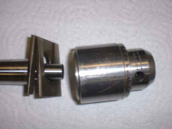

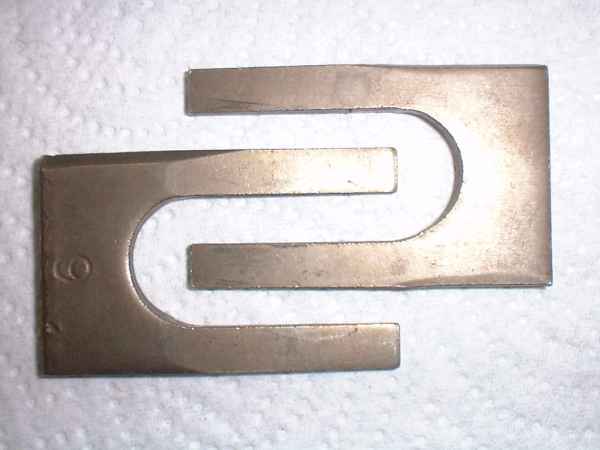

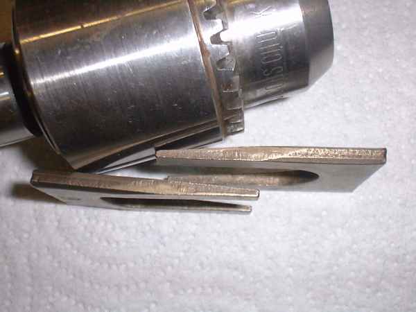

Default Wedges
Side view, showing the taper.
Lying flat:
In place to remove the chuck:
So you just take a hammer & tap them together.

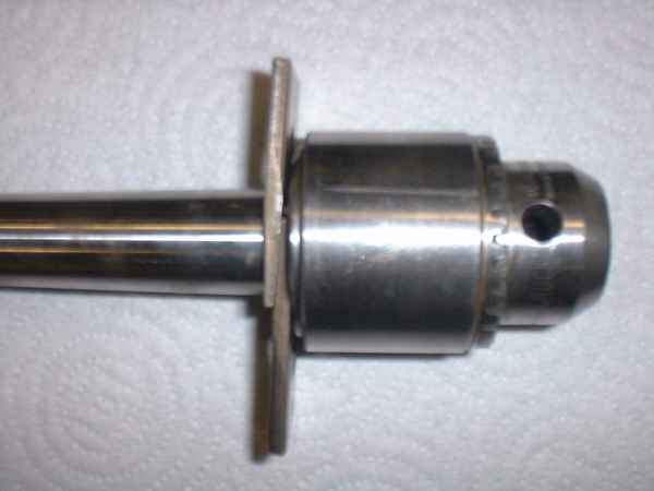

Default Done deal
And showing the chuck removed:
But I get the sense that yours is held on by a screw arrangement because of what you're saying about "wobble", but now you know - I hope.

Default
Quote:
Cutter, no screw in there so must be a taper. Now to find some wedges. While I had it out I miked the quill end best I could and got the the following; Length 3.100, Lg Dia .700, Small Dia .580. From the taper charts
this seems to be a #2 Morse Taper. Whats in the chuck T.B.D..Thanks for the great pic's.
