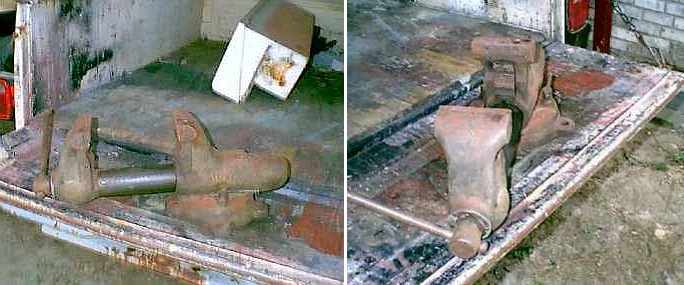

I found this old Wilton #6 (Chicago, Ill.) last month lying in the weeds out behind the wellhouse belonging to one of my customers, a woman who is selling the property & who has since moved to the DFW area. God knows how long it had been there.
This sucker is huge; that is an 8 inch Crescent I tossed in front of it for scale & it weighs in at 105 pounds. The moving jaw is stuck inside the receiver and so far has resisted all manner of prying, tapping and banging. Since taking the picture, I have successfully removed the swivel base (had to use an 18 inch pipe wrench on the holddown nuts), and the screw came right out. The nut feels good, believe it or not & the screw had a fair coating of grease on the threads. I got the handle freed up, too. Besides the stuck jaw, the collar or yoke is missing and the 3 screws that held it in place are broken off in the casting. I figure I can make a new collar, drill out the old screws and re-tap to a slightly larger size if necessary. Now if anybody just happens to have a collar lying around, I would happily pay the postage & maybe buy you a brownie or something?
My brilliant plan so far is to haul it over to my shop & hang it from a hoist by the moving jaw - just off the floor - and heat the throat with a torch to see if I can break it loose. Any better ideas?

Thats a good looking hunk of iron. I'd soak it with some "Kroil" for a couple of weeks, before I attempted to do anything else.
That will make a real good vise. I have a 5" swivel jaw Wilton that I've had for over thirty years.
____fla jim's signature_______________
Jim the shop rat
From the depths of the "Magic Garage"
posted by: Franz
Cutter, that vise is an ideal candidate for ELECTROLYTIC derusting.
It's going to take some time in the tank, but electrolytic will remove the rust, and make disassembly simple.
I'd start by hanging the vise in the tank from the screw, and cook it for a while, then unscrew the screw.
From there, change where you connect and derust piece by piece.
We've successfully derusted seriously corroded hit & miss engines using electrolosys as part of the disassembly process.
Chances are that vise was tossed because the setscrew in the screw retaining collar came loose, and the owner didn't know how to tighten it.

Cutter, Wilton doesn't build 'em like that anymoreI That baby is cast steel, not worthless cast iron. Five years ago, that No. 6 sold for $1200, can't even guess what it would go for today. Today the vise market is flooded with Chicom junk and I think even Wilton has rolled over and may now build some there.
I agree with Franz and Jim about using a derusting solution or a penetrant like Kroil or Knock'erloose. I've gotten aircraft constant speed drives (CSD's) with coked and hooked splines separated from generators with Knock'erloose. That's about a $100K combination. I'd be inclined to use the derusting procedure first on your vise.
There's something else you should know. The back end of that model should consist of a cap which is retained by a pin. If you can find that pin and drive or drill it out, you should be able to remove the cap. You may need a slide hammer. That should provide better access from the back end for the derusting or penetrant to work. You can still buy parts for this model, but bunch your muscles when you ask the prices.

Old man Wilton got dunked into the vat yesterday and started on the road to recovery, I hope. This picture shows the results after about 18 hours into the rust removal process. Nastier looking than anything I've done before, but then this was a really rusty old vise, too.

Okay, I got a couple of "in progress" pictures. I managed to wrestle the beast out of the soup without straining my uterus or anything at about the 22 hour mark, yesterday afternoon. I rigged up a crude tripod & used an old wire-stretcher from my antique tool collection to temporarily suspend it by the moving jaw, hoping its own weight would begin to free up the slide. No luck yet. Banging on it didn't help either. So I laid it down & got a few shots to show you.
Here is a side view:
In the picture in the previous post, you can see that I lightly wire brushed the ball shaped area on the left side of the pic, on the moving jaw. That was with a few strokes using a hand-powered brush so the rust is dissolving pretty fast. I thought this might encourage some of you who said you are waiting to see how this turns out before you give it a try. Here is a closer look where you can plainly see the process is working very well:
The best news of the 22 hour report is that I was able to get 2 of the 3 broken collar screws out of the jaw. These are the screws that once held the retaining collar which keeps the main screw locked into the moving jaw. (The collar is missing.) The top screw is broken off flush. Think of the vise grips as being at the 9 o'clock position; the flush-broke screw is at 12 o'clock & three o'clock is protruding from the casting. I'll leave the problematic one until I am finished soaking the whole thing, then figure out how to get a grip on it. I was very happy to get the first two out so soon.

Here is a combined shot of the vise to show some contrast & give you an idea of the rate of progress. The top is the original condition, the lower was taken at about 44 hrs into the process. I used a hand brush very quickly on it & discovered some of the factory paint. If I were only interested in the appearance, I could probably finish it off with a wire wheel at this point but the sliding section is still frozen. This picture was taken 2 days ago; I hauled it out & checked it yesterday - still stuck. I was in a rush to leave for work so didn't bother with more photos.
This a detail of the front of the sliding section at the 18 hour mark on top and the lower was taken at about 44 hours. You can also see right down the gullet. I am beginning to doubt that I will be able to budge the jaw until I either buy or fabricate the collar so I can use the screw to back the jaw out. No time for that right now. However if anyone still doubts whether the process will remove rust, this 2nd picture should be proof enough.

I hauled it out of the vat & spent half the afternoon trying to shake the slide out of the throat, all to no avail. First I tried hanging it by the front jaw again & banging on it with a 2lb hammer & a 2x4. Nothing. While it was in a more or less vertical position I kept the groove around the slide filled with penetrating oil just for the hell of it.
Then my son & I tied a comealong to a stump & chained the vise to a utility pole, trying to get as straight a pull as we could & used a 4 foot cheater on the lever. Not a hair of movement. So back in the tank it went.
There was some good news, though. I Dremeled a slot into the last of the broken collar screws and backed it out with no effort at all. Once I got a few turns on it, I finished it with my fingers. A combined shot of that is inserted below. I will paste together 2 or 3 shots of the present external appearance of the vise in a following post.
Grrrrrrrrrrrrrrrrrrrrrrrrrrrrr. First the damned software said to make it no larger than 800 x 600 so I resized it to 800 tall 356 wide. Still too tall. I guess that means the maximum dimension has to be the width? I'll have to redo the pasteup.
(3 minutes later) Okay, here's 3 postage stamps pasted together:
At this point the external surfaces appear just fine to me. There seems to be nothing left that wouldn't blow right off with a wire wheel. I guess I'll just leave it in the tub for another week & see what happens, after all it's not like I'm desperately needing it to use to keep the locomotive from running over the sexy girl tied to the tracks..... . .
Hmph!!!
I was sitting here, nodding at the keyboard & wondering how this thing could be so (John) Eff-ing stubborn when it occurred to me that every time I took a picture right up the gut, there still seemed to be a lot of rust. Then I realized that I had been laying it on the same side all week. So I began to wonder if the shape of the inside might be trapping air & preventing the water from reaching as much as 1/3 of the cavity? Sure seems likely to me.
So I took a little hand pump out there, purged the air of it and pumped water into the hole; bubbles rolled out of both ends. Now this might not constitute an acceptable test in your lab but it sure made me willing to roll that puppy over and do the pump thing again before going to bed. So I did just that.
Dang! Now I have to get all sleepy again - that water ain't just dirty - it's cold!

Well all this over a walton vice made me want one,I went looking!! found a Wilton 5" Combination Pipe & Bench Vise!! I ran a search on it and came up with this,
Item Number: WILC-2
Normally Sells For: $1097.95
Our Price: $783.61
Now this is a old one but in good shape,came from a junk store in Fla. I have 25.00 in it needs cleaning up alittle and some new paint. What you all think bout this one?
It would have been nice to find one the size of urs cutter But then u get what ya find!
Well guys this is the last one.Thanks for looking and i wish u luck hunting a good vice!!!

Very cool 7018!! Or as they say on the OWWM site "you Suck!".
That is their highest compliment on a great find.
How about giving us some dimensions? Looks like a 5" jaw width but was is your max opening, height,
weight & so forth. I wish there was some way of dating these things but I don't see anything to go on.

Well cutter they said 7 inch open but i opened it to 8 1/2 inches and it will hold 4 inch pipe they said however i havent tryed it as yet. got it out of the truck and took the pic.s so thats all i know so far. And i was hoping to find out how old this thing was! it has some weld splater on it but not much, all the jaw's look good not to much wear. But like i said wish it had been bigger,i'll stell be looking for a bigger one. And thanks for the reply
